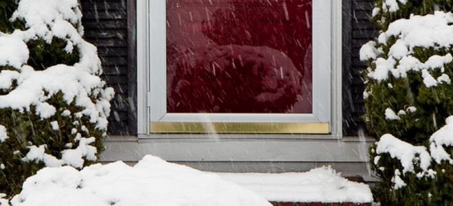

A storm door sweep is a panel located at the base of your door that is used to keep air flow from entering or escaping the building, and to keep out unwanted bugs and pests. This unit is pretty standard on all types of doors, and the doors thickness will determine what size of replacement you are going to need. The bottom of most modern doors have slots built into them, so that the old sweep can simply be pulled off and the new one slipped on in its place. Some alterations may need to be done for older doors, such as having to take the door off the hinges, and removing the old sweep with a hammer or pry bar, before nailing a new one into place. We are about to go into detail about how to change a door sweep on a modern slotted door that is ready for sweep maintenance from wear and tare.
