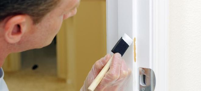

Step 7 - Fill in Gaps
If any gaps exist in the wood after you have inserted the wooden jamb piece, fill these gaps with wood putty, wiping away any excess when you are finished.
Step 8 - Sand and Paint
Once the wood putty has dried, sand down the joints between the two pieces of wooden jamb and paint the entire new jamb to make it appear flush with the other pieces of jamb.
