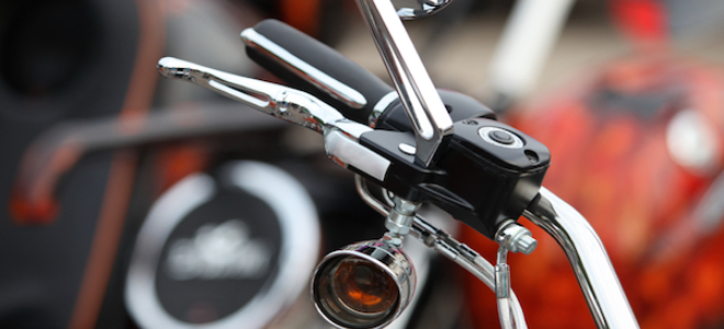

Motorcycle handle bars and throttle
Use the socket set and an appropriate sized socket wrench to release the bolt on the cable assembly on the handlebar. If your motorcycle has different assembly fixtures use whatever appropriate tool is needed, but it is usually a socket set. Remove the assembly from the handle bars. Pry open the assembly and unhook the cable from the housing.
