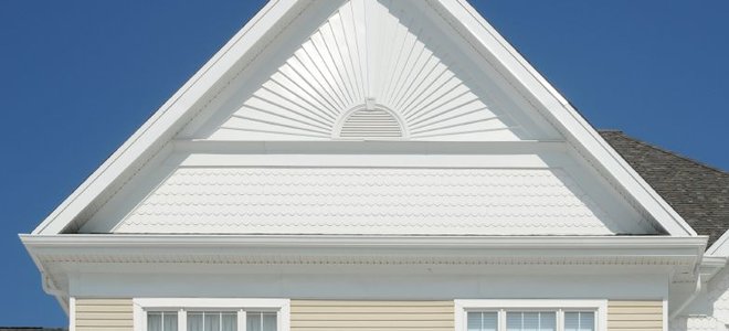

How to Replace Vinyl Windows
house with vinyl windows

Replacing vinyl windows is a manageable DIY task for most homeowners. Replacing these windows is much easier than regular wood windows, or large casement windows. In fact, specific vinyl replacement windows are made for a simple install. If you are thinking about replacing the vinyl windows in your home with new ones, here are some steps to take for a quick, successful, and air tight install.
