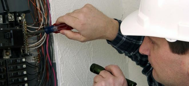

Step 1 - Turn Off Fixtures
The first thing you need to do is to switch off all light fixtures and unplug any device that might have caused the problem. Then equip yourself with a flashlight to ensure that you have plenty of light while working on the circuit breaker.
Step 2 - Find the Panel
Locate the electrical service panel which should be positioned where the power comes into your home (for instance, entrance, garage, or basement). The panel will either have a lock with a key or a plastic latch that needs to be opened. If you examine the circuit breaker, you will see that the switches have three positions—ON (towards the center of the panel), OFF (towards the edge of the panel), and a middle point. If the switch is in the middle position, it has tripped and needs to be reset.
Step 3 - Push the Switch
Push the switch towards the OFF position and then, push it back into the ON position, towards the center of the panel. You will hear a click sound. If the switch stays in this position, you should have successfully reset the circuit breaker, and the power will be restored. As a precautionary measure (in case there are sparks from the electrical service panel), it is advisable to wear safety glasses and stand to the side of the panel. In addition, make sure that your hands are dry and you are standing on a dry surface.
