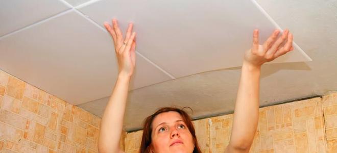

Most decorative ceiling tiles are not made to be restored. Damaged tiles must be replaced, because the material they're made from is extremely fragile, and even a slight amount of damage could be impossible to conceal. There are a few small tricks of the trade that can be brought to bear, though, including hand tooling edges, resurfacing tiles, or painting over the whole ceiling, as the steps below outline.

Step 4—Replacing Bad Tiles
Rearranging tiles is only a practical solution when their flaws are slight. Any badly damaged tiles have to be replaced. There are no ways to fill gouges or cuts in ceiling tile, and broken ones cannot be repaired. Remove the damaged tiles carefully and replace them with new tiles. Remember to keep the direction indicated on the tile back aligned with the other tiles in the ceiling.
