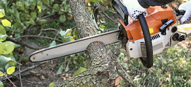

A chainsaw cutting a log
Before you begin, make sure you are wearing the proper protective clothing. Even experienced handlers should wear a hard hat, a good pair of gloves, as well as ear and eye protection.
Most chainsaws should be laid firmly on flat ground with the blade end pointed away from your body. Place your left hand on the handle and right foot on the appropriate spot to steady the chainsaw so you can properly pull the starter cord with your right hand. These points should be clearly illustrated in the owner's manual. Find any safety brake and release it. Prime the saw if it is gas-powered or make sure any electrical power cord is laid out safely. Pull the cord upward and close to your body to reduce potential shoulder injury. Know how to shut the saw off before trying to start it and how to release a chain brake.
