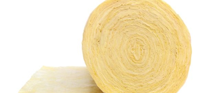

A roll of insulation.

Decide what type of insulation material is the best for your needs. While there are many different materials available than discussed here, the most common material is fiberglass, which is made of sand and recycled glass. Fiberglass can range from R-11 to R38. It's a good choice for any area of the house (attic, basement or crawl spaces) because if it gets wet, it will dry quickly while retaining its R-value. Fiberglass is also non-combustible. It comes in batts or loose fill. (See below for more information on batts and loose fill.)

Batts are like a thin-width blanket and come in rolls. They are so easy to install that even a novice DIYer can do it. They are packaged in rolls and come in various thicknesses. To know which thickness to use, measure your joist spacing. Batts come in 16” or 24” widths to fit between joists. They also come with or without facing, which is a vapor barrier that is attached to the back of the batts. You need a vapor barrier only if it is the first layer of insulation.
