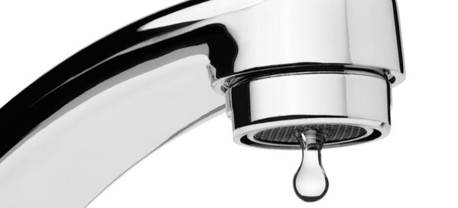

Leaking faucets are not only nerve wrecking, they can also run into costly bills. Small leaks that are left without any correction can use up to as much as three gallons of water and the bill from a plumber to fix the leak can be expensive and totally not justified. Most of the times, a leak can mean that the washer is damaged and needs changing and this is a very straight forward job that anyone with a little bit of patience can do on his or her own at home saving time and money.
