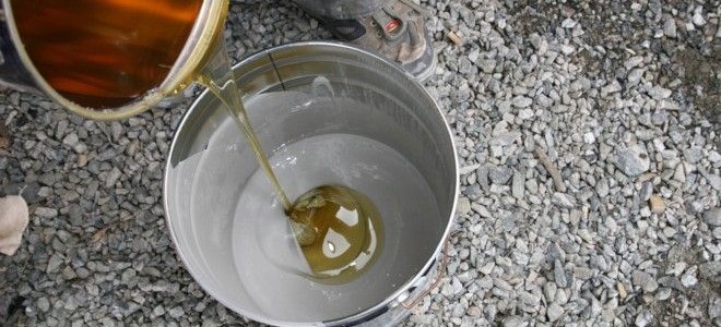

Step 4 - Measure and Mix the Sealant and Non-Slip Additive
Follow the maker's directions for both products to mix them effectively for the best sealing and anti-slippage results.
Step 5 - Apply the Protective Sealant to the Floor
applying epoxy sealant to a floor
Start at the farthest corner from your exit doorway or garage door. Pour a circle of protective sealant about 24 inches across. Use the long-handled roller to spread the sealant out evenly and in a thin coat. You can add a second coat after the first has dried, so work quickly to put on the first coat. These sealants are solvent based so they have a high level of volatile fumes. Be sure you work in a well-ventilated area and wear eye goggles to keep your eyes from watering. If you are putting sealant on an epoxy floor inside the house, open all the nearest doors and windows to improve ventilation, and wear a painter's breathing mask. Run two electric fans, one inside and one outside the room to create an air current that can help dissipate the fumes. Apply the second coat 24 hours after the first coat in the same manner. The floor will be able to take heavy traffic, such as a vehicle, seven days after the last top coat of protective sealant is added.
