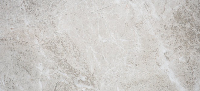

Limestone floor tiles are a durable type of natural stone flooring. Limestone is a porous material and needs to be sealed in order to prevent any stains or moisture from penetrating and damaging this beautiful stone. An specialized sealer made specifically for limestone must be used in the sealing process. The sealer should be applied when the limestone is installed and every two years after that to maintain the beauty of the stone. You will know when your limestone tiles require resealing by the way any water sits on the stone. Water on a protective seal will bead. If water no longer beads on the surface, the limestone needs to be resealed.
