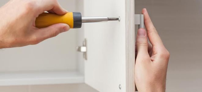

Install Magnets
For an easy fix for the cabinet door that continues to pop open every time you try to close it, you can install magnets to the door and the cabinet frame.
Line Up Magnets
white cabinet doors with honeycomb design
You can purchase a magnet set that will attach to cabinet doors that contain two magnets at different poles. When the one gets in line with the other it will hold together. Install one set on the inside edge of the cabinet face. It should mount flush with the edge so the door will shut. Screw it in with a screwdriver or a drill.
Attach Door Magnet
Line up the door magnet with the one that is on the cabinet face. Screw to the inside edge of the door. Close the door to make sure the magnets line up and will keep the door from popping back open. Make any adjustments you need to in order to keep them secure.
