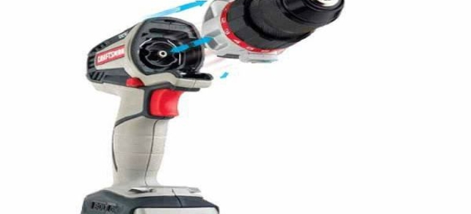

Drill
Drill tile bit

Step 2 - Drill the Pilot Hole
Use a tile drill bit and aim it at the center of the “X”. Use a drill bit that's slightly smaller than the screw. Apply even pressure to make the hole.
