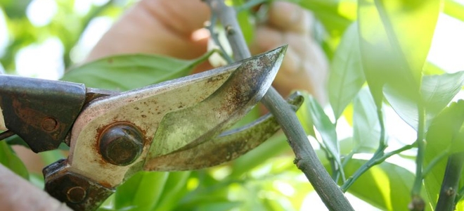

pruning a tree with loppers
Take each component separately and wash in a bucket of warm, soapy water. Use the brush to remove dirt. Pay extra attention to nooks and edges of holes where dirt tends to get trapped. Wipe all components with a dry cloth.
