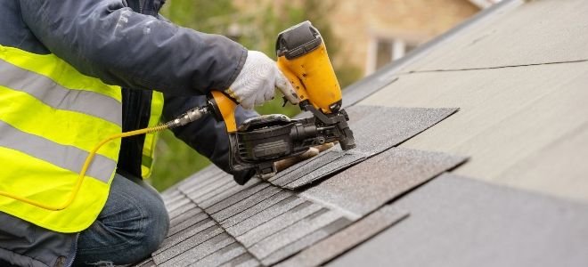

Whether you're building a new structure or repairing an older home, knowing how to shingle a roof can save you a serious investment, and protect your dwelling from the elements.
Step 1 - Prepare Safety
Before getting on the roof, equip a safety harness with a roof hook to prevent you from falling to the ground below. You may not end up needing them, but you're better off safe than suffering significant injury, or even death.
1.1—Sweep the roof deck of all dirt and carefully check the decking carefully so undesired nails, wood pieces, or other obstructions don’t end up underneath the underlayment.
