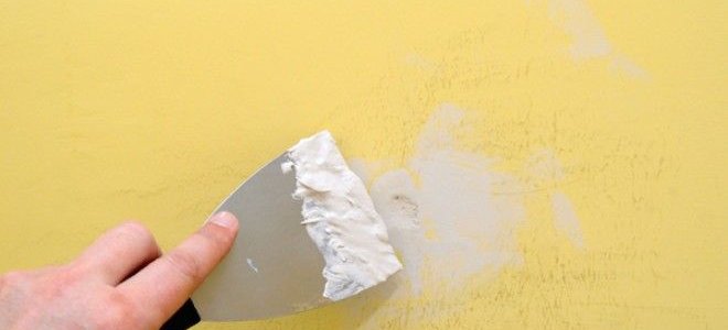

Step 3 - Fill the Large Hole
applying putty to a hole in the wall
Scoop a generous amount of spackle putty from the container and push it into the hole till it is firmly packed. Smooth more putty around the edges of the hole so no rough jagged points are visible. The putty will ooze a short distance out of the hole but will settle as it dries. Swipe the small putty knife over the hole until the surface feels level with the wall. Check for small holes and tears nearby and fill these with spackle putty, too. Level the small fills and allow all the spackle to dry. It will be glaring white with a firm, gritty surface when dry. If the hole is quite large, you may need to allow one layer to dry and then add another layer on top of it until the hole is filled.
