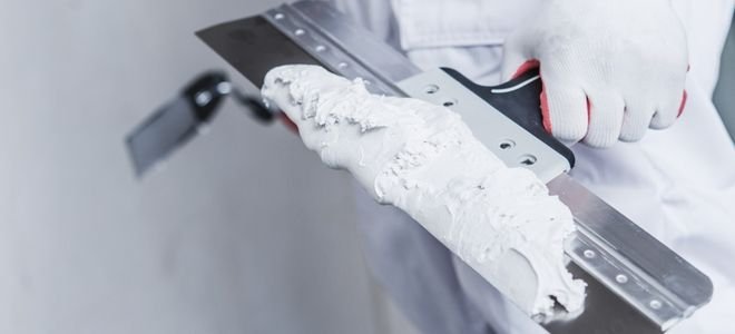

Step 1—Mix the Spackle
According to the direction on the bag or bucket, add water to the spackle. Using the paddle mixer attachment and your drill, mix the spackle until it is a creamy texture. Add a cupful of water on the surface of the mixed spackle. This will stop the spackle from drying out as you use it. This is especially helpful to the do-it-yourselfer because you may not move at the speed of a professional.
