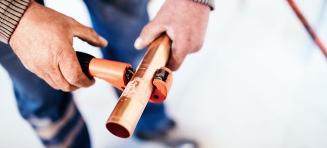

Step 3 - Cut Copper Pipe
When you splice into a copper supply line, you usually are adding a new line. To do this, you must first cut the existing line. A pipe cutter looks much like a clamp with two small blades in the middle. You place the cutter on the pipe and tighten the knob. As you turn the cutter, continue to tighten the knob. This presses the blades into the pipe, cutting through it.
