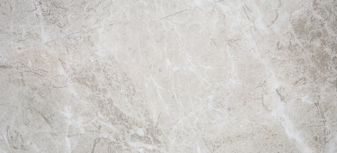

Limestone tiles look lovely in a room or an area. You might decide, though, that you want to color the limestone tiles to match the décor of your house. It’s not a difficult job, although it requires patience. At heart it’s similar to applying color to concrete as both are porous.
