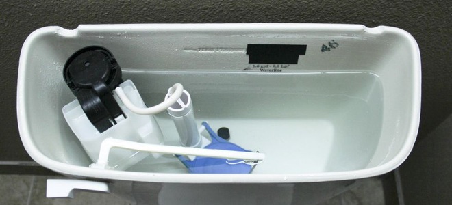

Insides of a toilet tank

Inside a toilet tank with parts labeled
