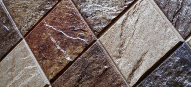

Tile and Grout
Add a wire mesh to your green board. Nail or screw the wire mesh to your already installed green board. Apply tile concrete to the mesh. Only add a thin layer of tile concrete. Smooth completely with a trowel. Add your tiles to the wire mesh. Using spacers, space your tiles appropriately along the wall. Use a level to keep all your tiles in line. Allow it to dry for another 24 to 48 hours.
Apply the grout to the tile. Do not add more grout than needed. Allow your project to dry for at least 48 hours before use.
