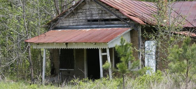

Treatment and repair of a rusted tin roof can be easily achieved at home through some perseverance and hard work. Rust on your tin roof can cause major damage and compromise the safety of the structure. Therefore, you need to attend to the problem at the onset to reduce and limit the extent of the damage. Given below is a simple process that you can follow to remove rust and treat your tin roof.
