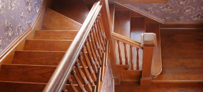

Installing trim on a stair railing can improve the look and finish the area. It’s something that takes some thought. The trim itself isn’t on the handrail, whose aim is to provide support as you go up and downstairs. Instead, the trim is over the horizontal area and down the vertical area, on top of the drywall. Using wood for this can help it blend in with other woodwork and give a final touch.
Step 1 - Design
Start by deciding exactly where you want to place the trim on the stair railing. Generally, this will be on a relatively small surface on the top of the stair wall. You’ll also need to go down the vertical on the edge of the wall at the bottom of the stairs, and also on the riser up to the ceiling at the top of the wall.
