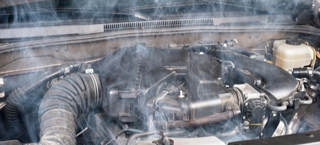

An overheating engine in your car can damage the motor in major ways, resulting in hefty repair bills. If your car starts to smoke, check the engine right away to find the cause of the problem.
Your main line of investigation will be the cooling system, which includes the radiator, water pump, thermostat, intake/output hoses, and cooling fan.
