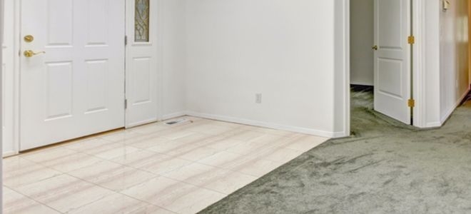

A carpet power stretcher can be used to install a new carpet as well as for restoring the old, existing carpet. If your carpet has become worn-out and has become very crumpled, then using a carpet power stretcher is definitely the best solution. This will smooth out your carpet and will bring it back to life. Usage of a carpet stretcher will allow you to stretch the carpet professionally without rubbing off your knees. Read below to figure out how exactly to use a carpet power stretcher.
