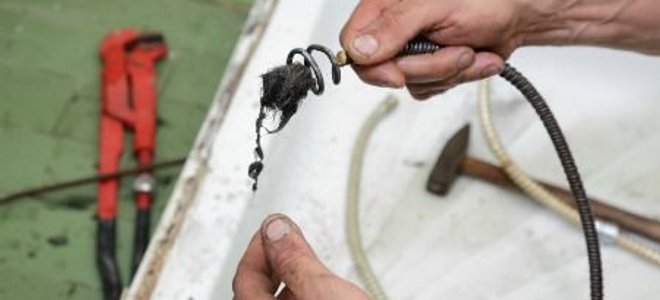

A drain snake (also called a plumbing snake or drain auger) is a long, flexible, metal cable with a cone shaped auger on the end. A home drain snake is small (about 50 feet long) and usually hand-powered, and it’s called a snake because of its obvious resemblance to a real snake. You use a drain snake by feeding the end into the drain and pushing it through the drain line while turning a handle to keep the cable spinning inside the pipe.
Since the snake is flexible it can bend around the twists and turns of the drain pipe without getting stuck, moving forward until it reaches the obstruction in the line. Here, the twisting motion of the auger end hooks onto any clogs so they can be pulled back out of the drain.

Start by spreading some old towels around the area. Put on some protective gloves because you will probably be touching the cable after it comes out of the drain and also touching whatever caused the clog. Use work gloves for this, as the coils of the cable can grab onto thin latex gloves and rip them off. Also, have an empty pail close by to discard the debris after you get it out of the drain.
Put the auger end of the snake into the drain and feed the cable in while turning it. Work slowly, and keep twisting the handle on the snake as it works its way along the pipe. If you are snaking out a tub, feed the auger through the overflow drain, not the drain in the floor of the tub. You will probably have to remove the cover to do this, but going through the overflow prevents the snake from traveling up the air vent to the roof rather than following the drain.
When the snake encounters the blockage, you will feel the cable back up. Keep cranking the cable so it catches onto the clog. When you feel resistance against your turning, slowly pull the cable back out and take the clog with it.
