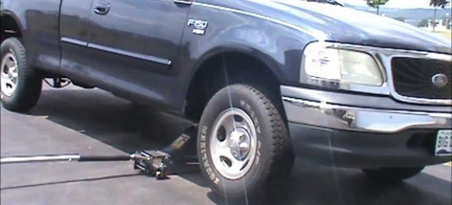

Floor jack lifting a pickup

For the purposes of this how-to information, we are referring to the first type of floor jack mentioned above. Apart from the floor jack, the user would need cinder blocks or 4 x 4 wood blocks, and 1/4 inch plywood sheet.
To use the floor jack, first ensure that you are using the right one for your car type. All floor jacks would have the weight written on them. Choose the right weighted floor jack for your vehicle. Ensure the surface on which the vehicle is parked is level.
How to Use an Automobile Floor Jack
Park the car where the floor jack is placed and chock the wheels that do not need to be lifted from the ground with the cinder or wooden blocks. Slide the floor jack under the vehicle and position it so that the lift portion makes contact with the car's undercarriage. Follow the specifications and look for the lift point for the specific model.
Pump the handle of the tool to raise the vehicle until the end is lifted. If you would like to carry out tasks under the car, place jack stands under the vehicle for added security in case the car accidentally lowers. To lower the vehicle, turn the handle in the other direction.
