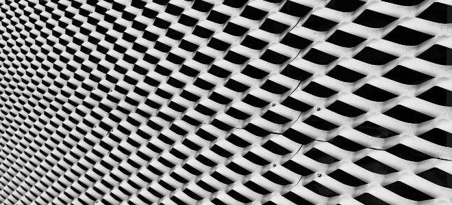

4. Hang the Lath Horizontally
With the sheathing in place and papered you can work on the lath. Use two inch nails to attach the mesh to the sheathing layer. The mesh needs to be overlapped at the seams just as the paper was. You also want to nail in the lath every 16 inches, both horizontally and vertically to create more support.
You will need to make sure that your metal lath is hung horizontally. The joints that are made between each of your panels need to be laid in a type of a brick pattern. The seam that you use between your first and second panels that go on the bottom of your wall need to fall right in the middle of your panel. You will then put them directly above them immediately following this.
5. Apply Mesh
Your metal lath that is expanded will come with a mesh that is diamond shaped. For you to be able to have a proper holding base for your plaster or stucco, the pockets that are formed by your mesh need to face up. The mesh that you are using needs to feel rough whenever your run your hand down it and smooth when you run your hand up it.
6. Finish up
Make sure that you attach the lath with roofing nails that are 16 inches. Cut your lath with shears, a circular saw will be necessary for a bigger job.
