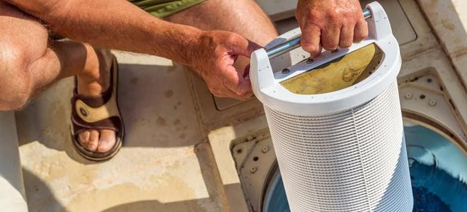

Step 5 - How to Clean and Rinse the Cartridge
hosing down a dirty pool filter
Turn off the filter unit. Open the top and take out the cartridge. If you have more than one cartridge, do them one at a time. Using a hose with a sprayer, spray the filtering vanes of the cartridge thoroughly. Check that all dirt and particles you can see have been swept out. Avoid high pressure sprayers as these will damage the vanes. Dip the cartridge in a weak solution of trisodium phosphate to release oils from tanning and sunscreen products.
