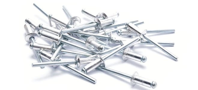

A rivet nut tool is your best companion when your projects require installations that require having a rivet nut fastener. It will make sturdy installation jobs easier. This tool will allow your rivet nuts to be seated tighter as compared to other tools available since it is specially designed to do this task. Rivet nuts have far greater loads than any regular sheet metal screw. Thus, a rivet nut tool is highly recommended. There are also many other applications where you can use the rivet nut tool which will make this a worthwhile investment.
