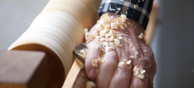

A wood lathe duplicator is a fantastic tool to use when you want to make a replica item such as a table leg or a bedpost. With the duplicator, woodworkers can easily turn identical pieces, even down to the intricate designs and patterns. For large scale projects, like creating identical banisters, or fence rails, the duplicator is an indispensable tool. Using the wood lathe duplicator does take a little bit of practice. With some helpful tips, and plenty of practice, any DIY woodworker can easily refinish antique furniture, or create new pieces from old.
