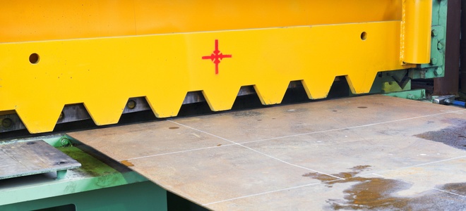

Practice bending your aluminum sheets with some scrap sheets. Have a feel first how the aluminum sheets bend before bending your aluminum sheet window cutout. Place the aluminum sheet in the pan brake. The pan brake has a break in the sheet where the brake lifts up to form the bend. Align the mark on your sheet aluminum with the break in the brake.
Step 5 - Lock the Brake
Most brakes will work by pulling down two levers to the side of the brake. The top portion of the brake will push down onto the aluminum sheet you want to bend, which will keep it in place while you bend the sheet. On the sides of the pan brake, there is a large lever with a weight on the top. Pull this toward you while watching the brake lift and bend the aluminum sheet. When the aluminum sheet is bent in the angle that you're looking to bend, release the lever, unlatch the brake and pull out your piece. Repeat the process on all the sides that need to be bent. Fit window wrap on your window to see if any more bending is required.
