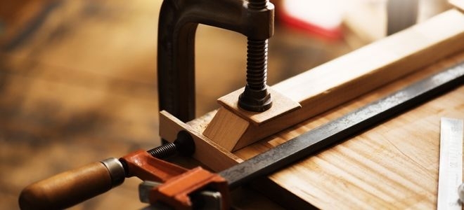

Bar clamps are handy for light duty woodworking projects that require clamping and firmly bonding two pieces of wood together. A bar clamp consists of an aluminum or steel bar and two jars, one is static (also called fixed head) and the other is a tail stop that can be adjusted with a screw mechanism and tightens when you turn the crank. They measure from 6 in. to 36 in length and can reach 2 in. to 2-1/2 in. Some are designed to join to pieces together, and others can be used to push pieces apart with outward pressure. Keep reading to learn how to use a bar clamp.

Step 3 – Clamp the Wood Pieces
Join the two wood pieces on your working surface. Don’t worry if the alignment is not perfect at first; you can loosen and readjust the clamps as needed. Adjust the bar clamp to fit the length of the joined wood, extending the jar opening an extra 3 inches. Place the fixed head and the tail stop against the edge of the two wood ends. Turn the handle (tail stop end) with the screw mechanism to clamp the two pieces together.
If you are working with soft wood, you may want to insert a piece of scrap wood between the jaws and the two wood pieces. This creates a buffer to prevent impairment to the wood being clamped together.
Use your fingers (you may want to use rubber gloves) to apply and glue to each part of the joint. Spread it around the edges.
Use moderate pressure. Don’t over-tighten. This could cause damage to the wood and even bending of the pipe. When you see glue being squeezed out, you’ve applied enough pressure.
Wipe off excess glue and let dry.
