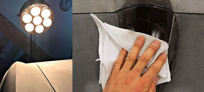

Step 1 - Prepare the Surface
You cannot start using the fiberglass cloth until you’ve prepared the surface to accept it. Start by using coarse-grain sandpaper on the entire area on and around the repair. The surface has to be scuffed until it’s smooth to the touch and dull.
Now, take a rag and acetone and clean the area you’ve just sanded. This gets rid of dust as well as oil and grease. If there are any traces of these, the fiberglass will not bond to the surface.
