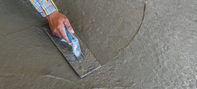

Step 2 - Feather Edge the Poured Compound
As soon as each full section is poured, feather edge the compound. Using your trowel, smooth out the outer edges of the section so they are as thin as possible while still providing coverage for the surface. Turn your trowel on its edge to do this. The edge will look like a series of overlapping feathers when done correctly.

Step 5 - Use the Trowel to Smooth Out the Compound
Smooth out and edge the compound with the trowel at once after pouring. Feather edge the compound along the edges of the space. Rub out any trowel marks from poured strips while the compound is still tacky. Use light pressure on the trowel to remove these marks.
