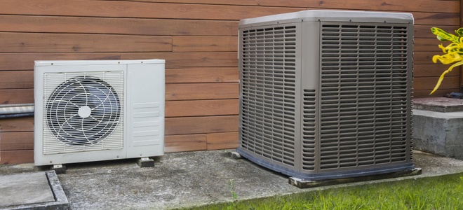

Sometimes you just need to shut it down. In electrical work and construction, a disconnect switch, also known as an isolator, can be used to separate an electrical circuit from the main power source. This can help ensure the equipment is completely de-energized while performing maintenance or servicing, eliminating the need to go back to the main electric panel every time it needs to be turned off and on.
Disconnect switches can be especially helpful for large appliances located far from your home's breaker, as is often the case with outdoor AC units. Electrical work like this is typically a job for a professional, and in some cases, it's even illegal to do without certification, but if you're interested in learning about this process, these are the steps.
Considerations Before Starting
Adding a disconnect to an existing AC unit is essentially a matter of cutting the 240 volt feed to the AC unit and adding the disconnect in between, thus bridging the current flow through to the AC unit.
