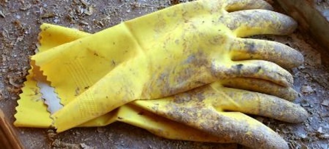

Step 1 - Get Your Gear On
As a safety note, most of these solvents are harsh. There's also an additional hazard present in anything that may come from the paint that could be inhaled.
Before you begin to strip paint from your door frames, window frames, and baseboards, first take the time to don the proper safety attire and gear, including chemical resistant gloves, clothes that will protect your skin, protective goggles, and a face mask or respirator. If the stripper gets on human skin, it will burn. Not to mention how harmful the vapors are when inhaled.
