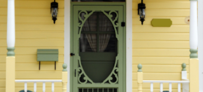

If you want both security and fresh air, consider installing a security screen door. These types of doors come in many styles, sizes, colors, and types. They also come with optional features that provide added security. Whether you do it yourself or have the door installed by a professional, it is important to know the installation process. This knowledge will add to the overall security of your home or business.

Step 7 - Install the Door
Front door with a screen door
You will want a partner to help hold the security screen door up while you put it inside the doorway. Be sure the door fits properly.
