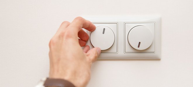

Dimmer Switch Tips
A dimmer switch and regular light switches.
There are several things you should know before you buy a dimmer switch. If the light only has one switch controlling it, then purchase a single-pole dimmer. If there are multiple switches for the same light, then you need a three-way dimmer. The downside to a three-way switch is that not all switches will be able to dim the lights, unless you purchase a specialty set. Further, dimmers are typically made to take up to 600 watts. Make sure your dimmer can handle that load by adding up the wattage of the lights hooked up to the dimmer. If the total wattage is over 600, then you should purchase a dimmer that is rated for heavier loads.
