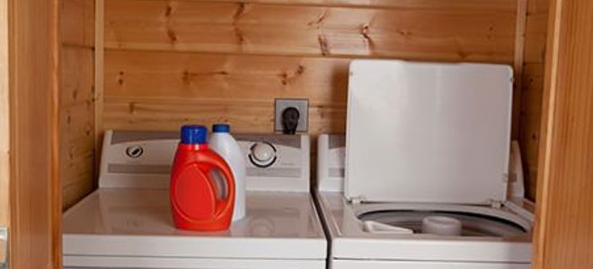

Venting a clothes dryer to the outside isn't an option - it's a requirement. An unvented dryer puts all kinds of fibers and lint into the air in the house that will not only accumulate and make a heck of a mess over time, but can cause respiratory and breathing problems for the occupants. Even more important, the hot air in the dryer (as a result of combustion) may contain gasses such as carbon monoxide that are extremely hazardous. These need to be vented to the outside.
Luckily, installing a dryer vent is a pretty straightforward job. As long as you can measure accurately and use a power drill or jigsaw, you can install your own dryer vent.
Step 1 - Determining Where the Vent Will Go
The first thing to do is figure out where you want your dryer vent to be placed. If your dryer is in the basement, you need to drill through the wooden sill plate that sits on your foundation.
If your dryer is on the main or second floor, you need to determine where you can cut a hole through the wall. When you think you've found the proper location, drill a small pilot hole and insert wire coat hanger bent at 90 degrees and spin it around. If the hanger doesn't hit anything inside the wall, your location is fine; however, if it hits something in the wall you'll need to find another location.
Check the vent locations from the outside as well. Do this by measuring (on the inside) from the corner of the foundation or even a window to your chosen spot, and then go outside and use the same measurement to verify that your location is OK. You don't want to run into any existing shrubbery or gate posts.
