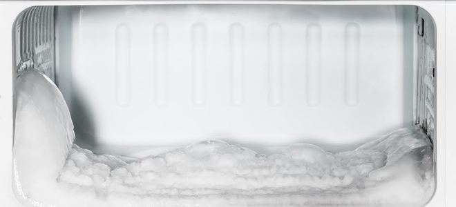

If you need a little extra storage space for your frozen foods, chest freezers are a great option. Follow these step to buy and install a chest freezer.
Step 1 - Select a Freezer
Select the freezer that meets your needs. Remember the best freezer for you will be one which fits in the space you have, runs economically, and falls within your budget. Also, remember a 220V home freezer will usually run more economically than a 110V one.
