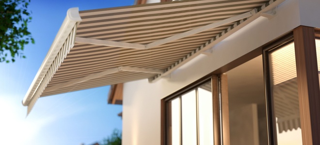

Placing a door awning at your front door is a good way to protect your entrance from the elements. It can also provide shade and help reduce energy bills. Your home's value may very well increase by adding an awning as well. An awning is something that can generally be done by yourself and won’t take more than a day to complete if you work through it. Here’s how you can create a shaded entrance for your home.
Step 1 - Measure Your Door
Measure your door and determine what size awning you would like. The awning should be at least six inches longer than the measurement of the door opening. With your fabric pen measure out this number on the fabric and mark it out, adding six extra inches to allow for overhang on the front.
