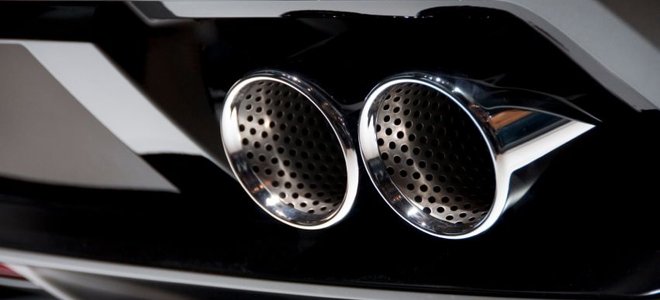

Aftermarket exhaust pipes are usually installed on cars or motorcycles to enhance the visual appeal or performance. You may just find that it is easier to find aftermarket exhaust pipes after your factory installed exhaust pipe has called it quits. Whatever the reason you are looking at aftermarket exhaust pipes, if you are looking to replace your factory installed exhaust with an aftermarket exhaust, you may be thinking of stainless steel. Stainless steel exhaust pipes may add more visual appeal to your car or motorcycle. But if you are looking to remove your old exhaust, and install the new ones yourself, you’ll find it’s better if you stay away from the stainless steel exhaust pipes. If you are sure that your catalytic converter has not become rusted together with your old exhaust system, this shouldn’t be a problem. Installing aftermarket exhaust pipes on your car can be done fairly easily in your own ventilated garage or driveway, and you may be surprised to know that you can do this with minimal experience or tools.
