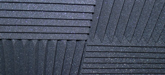

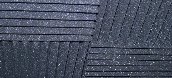

Acoustical Foam: This does not look as great as the fabric panels, but it is a great sound absorber. In fact, this type of material is used in many recording studios. It can be fixed onto any wall, ceiling, or doorway using adhesive and tack strips or nails.
