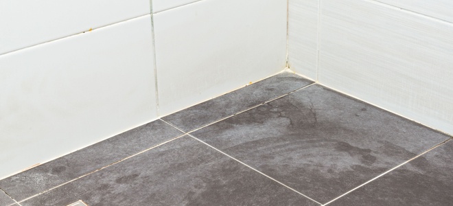

A very affordable and easy-to-do renovation of a floor uses peel and stick tile. These tiles work exactly as their name suggests.
Step 1 - Clean the Floor
The success of most jobs depends on the early preparation, and this preparation is very important with peel and stick tiles. The floor must be totally clean and dust-free. Fix any irregularities before you lay the first tile.
Step 2 - Find a True Corner
Find a true corner in the room or the longest straight wall for your starting point. Test the tile against the corner before you remove the backing to make sure it fits snugly on both edges.
Step 3 - Fit the First Tile
Remove the paper backing and fit the tile to the floor. Try to get the tile into the right position immediately. The adhesive is quite strong, and you will probably ruin the tile if you try to reposition it.
Some people tear the paper backing, and the parts left behind prevent the full adhesive surface from making contact with the floor. With care, you can remove all the backing sheets in one piece.
Step 4 - Fit Other Tiles
Repeat the process. Make sure each new tile sits tight against any others. The paper backing of peel and stick tile is very slippery, so you should immediately dispose of each backing sheet into the waste bin.
Step 5 - Fill Gaps
Once you fit all the tiles, measure and cut tiles to fill the remaining gaps. The tiles are difficult to cut with scissors. Use a sharp knife, drawn along a straight edge. It is safer to stand and use a table for cutting, but always make sure you have some backing material to prevent damage to the floor or the table where you cut.
