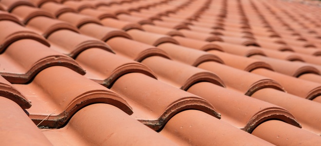

A clay tile roof.
Make perfect measurements to ensure proper, and straight installation. Lay chalk lines both horizontally and vertically to ensure you stay with your design.
Step 4 - Install Tile
Place a copper nail in the specified area that the instructions call for. Follow your design, keeping measurements accurate, until you have finished the roof.
