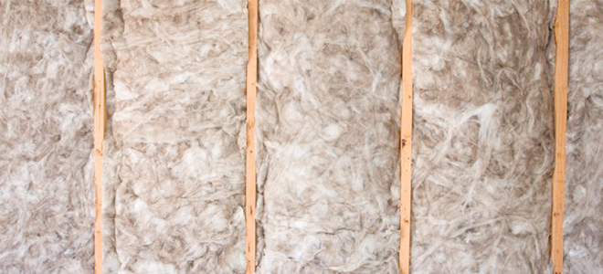

Old homes either don't have insulation or don't have enough of it, this can be a major problem, but it can be resolved by retrofitting wall insulation. Wall insulation is something that is required to ensure that your home is energy efficient and that heat isn't lost. When installing Retrofit wall insulation there are some important things to consider and bear in mind.
Choosing the right type of wall insulation will help to make your home much more energy-efficient. By far the easiest solution for retrofitting insulation is to use the blow fill technique. This uses loose fibers that are blown into the wall cavity through a series of access holes. While this does involve cutting holes in your wall it does mean that you can leave most of the drywall intact.

Choosing Insulation
There are a number of different types of blown insulation that are suitable for residential use. The most common types of insulation include cellulose, foam, and fiberglass. The type of insulation you choose will normally depend on the location where you are installing the insulation. Fiberglass is ideal for any areas which are hard to reach because it fluffs itself up and is a great insulator.
Cellulose insulation is made from around 80% recycled paper and fire retardant chemicals for safety. Cellulose insulation is useful for wall insulation because it has very fine fibers that fill any voids in the wall. When retrofitting insulation cellulose insulation should only be applied dry, this can take a long time to settle though.
