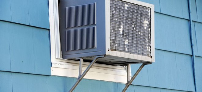

Step 4- Install the Air Conditioner
Once everything is assembled, open the window and slide the unit inside. The window should be high enough that you can slide the air conditioner underneath with ease. Air conditioners usually come equipped with a top and bottom flange, which help hold it securely in place. Position the unit so that the bottom flange runs right against the windowsill. Then lower the window until it abuts the top flange. The flanges should keep the air conditioner in place at this point, but it is a good idea if your helper holds it in place until the installation is complete.
Step 5- Add Angle Brackets
Most air conditioners feature a few angle brackets that help keep the window sashes from coming apart. Along with the flanges, the brackets are key in keeping the air conditioner in place. Start by placing the brackets on the top sash and marking where the screw holes should be placed. Drill a few pilot holes to avoid splitting the wood and tighten the brackets in place. Once the brackets are in place, pull out the side panels (the ones you installed earlier) and screw them into the windowsill. Once you reach this point, you can tighten all of the screws down and make sure you did not leave any out.
Step 6- Add Finishing Touches
A window air conditioning in a brown house.
The final step in this installation is weatherproofing the air conditioner. You want to create a tight seal around the open window so that inside air does not escape. Your unit should have come equipped with some foam insulating strips. These strips should be installed where the top and bottom sashes of the window meet. Measure the foam against the window and cut to the desired length. The foam should fit snuggly in the gap between the two sashes. If your air conditioner did not come with insulation you can always purchase some at your local hardware store. With everything installed, plug in the air conditioner and make sure it is running properly.
