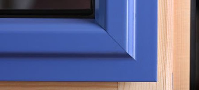

There are two primary methods of installing window trim. The first is called a wrap-around style, which consists of placing an identical piece of trim on all four sides of the window frame. This style is most often used in small rooms. It doesn't leave bulky pieces of trim protruding into the room. Since you are emphasizing the glass in the window instead of the trim, it can make the room appear a bigger. Here's how it's done.
Step 1 — Measure
Measure the top of the window frame from inside edge to inside edge and add 1/4" to that measurement. This will allow you to create a reveal of 1/8" on each side when you install the piece. Your local hardware store will be able to help you select the appropriate trim based on your measurements and a picture of the window.
Step 2 — Angle the Trim
Using your miter saw, cut one end of a length of trim to 45 degrees. Measuring from the bottom (or the shortest) edge of the angle you just created, make a mark using your measurements from earlier. Make sure to check your measurements twice, you won't be able to adjust the wood after you've cut it. Adjust your miter saw so that the next cut will be a 45 degree cut that results in your mark being the short end of the angle. Hold the piece in place around the window to ensure that you figured the reveal correctly, and repeat the process.
Step 3 — Nail it in Place
Beginning with the top, level and secure each piece with a few finishing nails. Don't drive a bunch of them yet, so you can remove it to make slight adjustments if it isn't completely square. Once every piece is in place and you are happy with each miter, drive a nail on the inside and outside edge of the face every 8" to 12".
