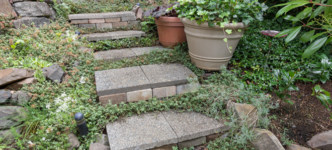

Concrete steps tend to look drab and grey and not very attractive. If you want to turn your old concrete steps into something more modern looking and exciting, you can put tile over them. Here are some instructions on how to the job:
